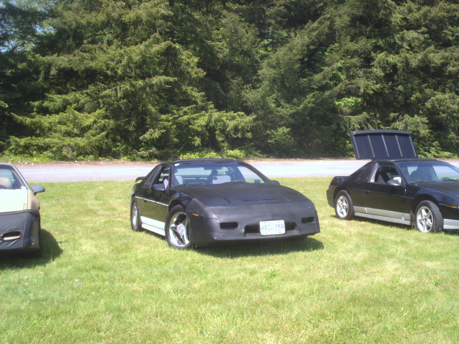

   This Page is about my 85GT that I have had for 9 years and has gone through a lot. I got the car in October of 94 about 9 years ago for 2950$ USD.  From a dealer in Oregon, the car had a full load of options power everything right down to A/C and Leather Seats.  When I first looked into the engine bay and saw the bright red FIERO peering back at me I was in love.  I took the car home that night.  Well to simply say it has been a rough road the past 9 years is an understatement.  I have blown up 2 motors so far, the 3rd is in the car now and getting ready to be removed due to a lifter noise. It is currently got its 4th tranny installed.   With all the problems that the car has had, it now has nearly 340,000 miles on it. I have upgraded the brakes to Grand Am, installed remote keyless entry for doors and trunk, installed a sub woofer, amp and CD player. Tossed the stock wheels and got a set of 3 spoke 16's for it. Tires are now 225/50/16 front and 245/50/16 rear.
This is a Pic from the 2003 Arlington Fiero Picnic  that I was at..
